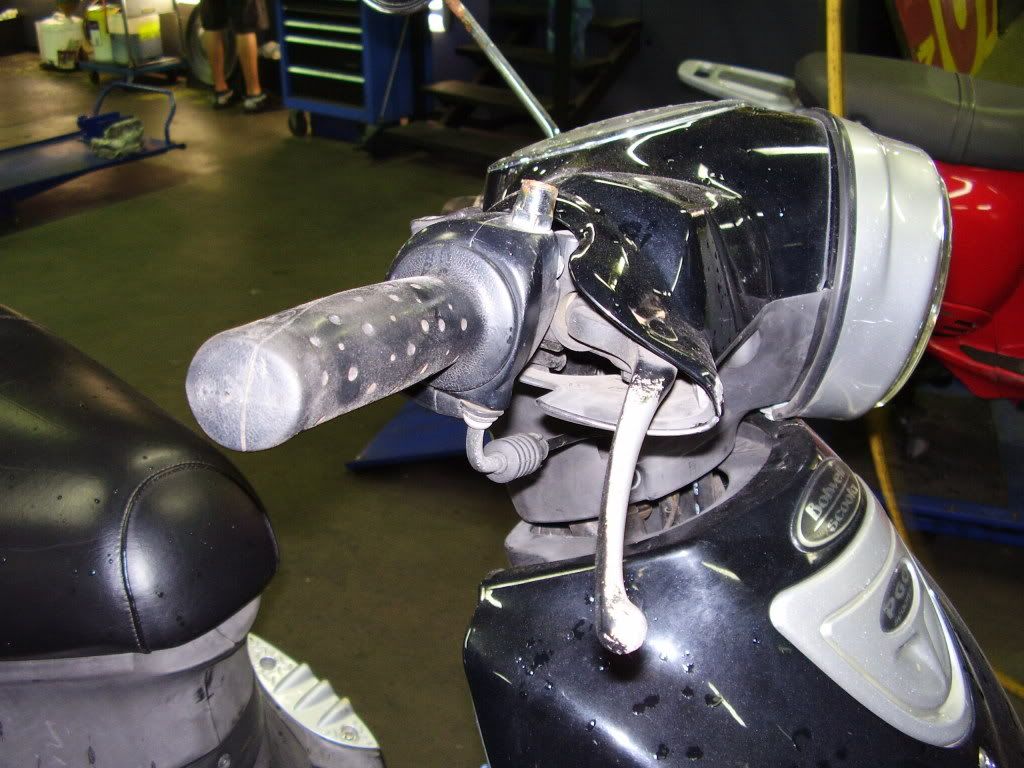

    FOR THE RECORD:
    When you delivered your scooter to our workshop on the 10th Dec it was lying on its side on an alloy tray of a ute. I brought the ramp over to assist you in removing the scooter from the ute. We noted that the scooter wouldn’t roll forward only backwards and it felt like something had jammed inside the transmission.  On closer inspection we noted an oil seal on the output shaft was damaged and had leaked all the oil out of the gearbox. The vehicle then had been ridden without any lubrication until the bike could no longer physically move forward because the entire gearbox had welded itself together from the massive heat build up. Every bearing inside the gearbox has been destroyed as have all the rest of the components and they require replacement. We have never seen a scooter gearbox so badly damaged before.
    Lever damaged from lying down on its side in the back of a ute. Broken R/H Mirror.

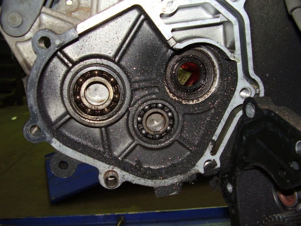

    gearbox cover - note all the sparkly stuff, that’s little pieces of you gears and bearings

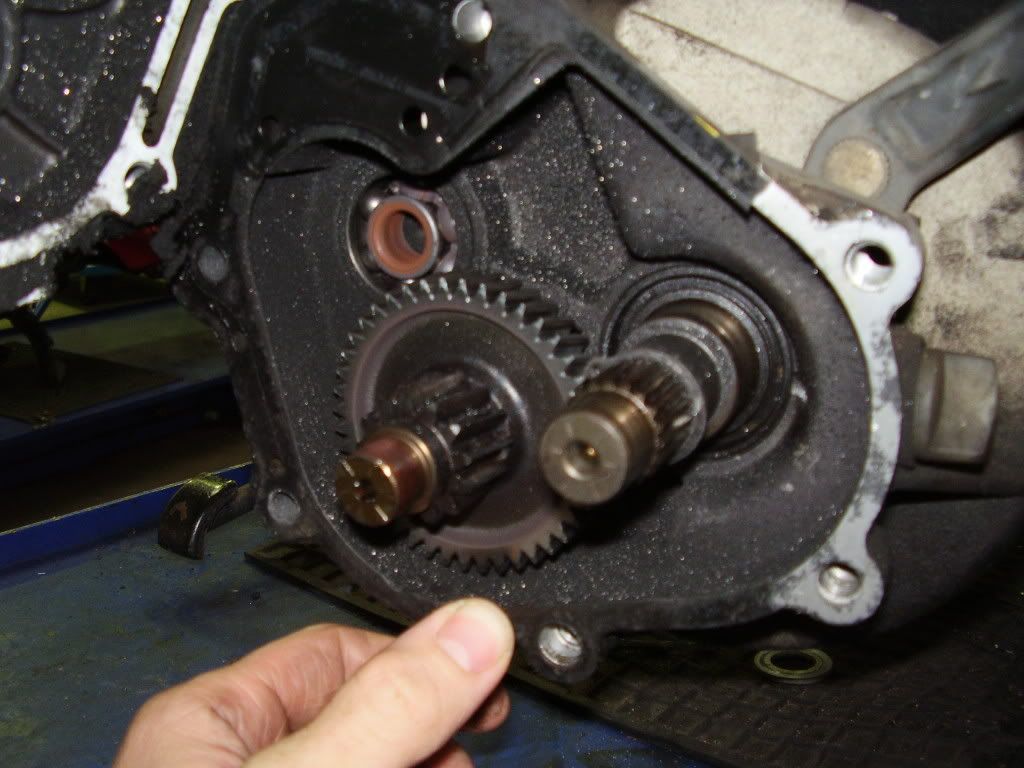

    Inner gearbox housing – more ex-bearing sparkle.

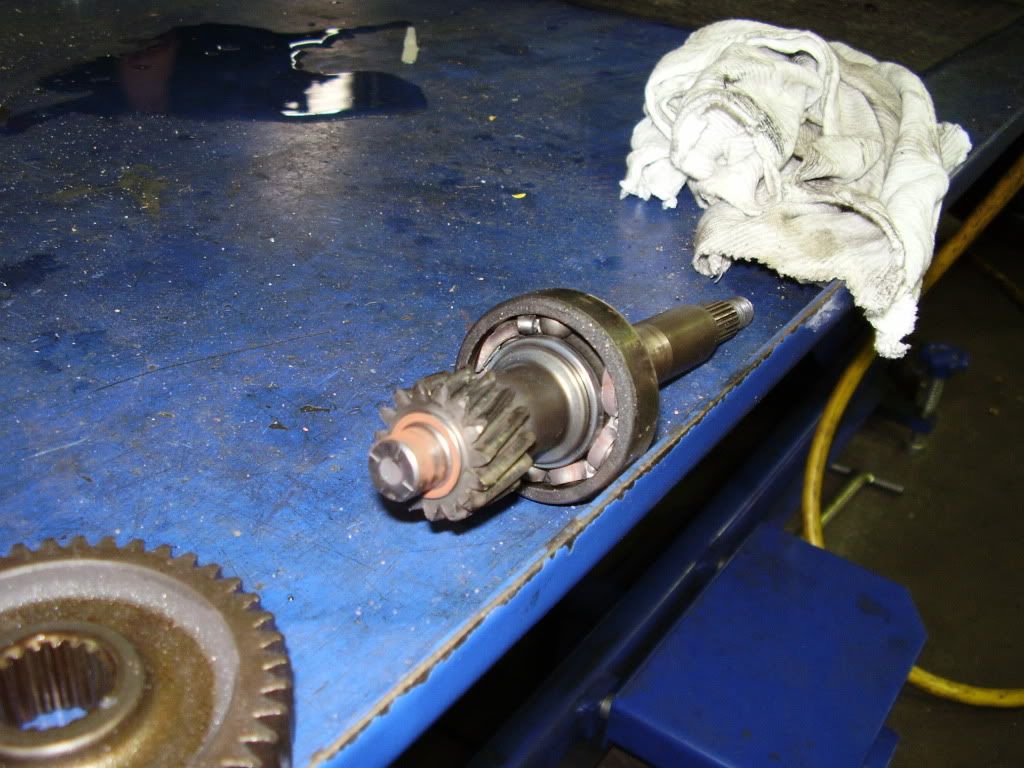

    Output shaft with absolutely stuffed main bearing with missing balls and shattered cage. The hypoid gear has been so badly worn from lack of oil it’s almost blue and the teeth have nearly worn through.

    I would say very likely the damage was caused by the rim
    The whack that damaged that rim would have tweaked the shaft and if the shaft is not running true then its going to over work the seal in which case you will have an oil leak
    Even if it didnt damage the shaft the vibration caused by that wheel will of, I think if you got them to fix the gearbox and not the wheel then in 6mths you will be wheeling, dragging it back in there front door
     The ironic thing is , if you had brought it in for a service they would have most likely found the problem and you would have been up for a much reduced bill
