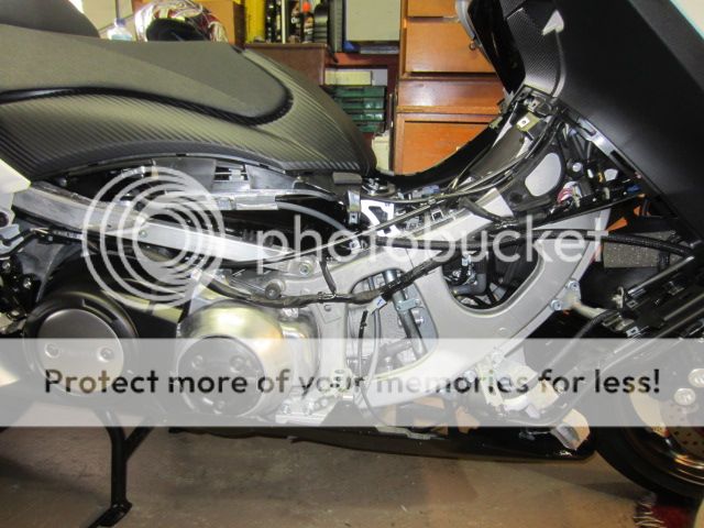

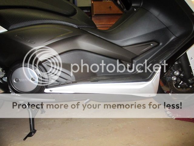

    What Happens When These Arrive...?
    And these one of these sitting in the garage...?
    Well its tool time...
    Basically all the panels shown here need to come off...
    To expose this -

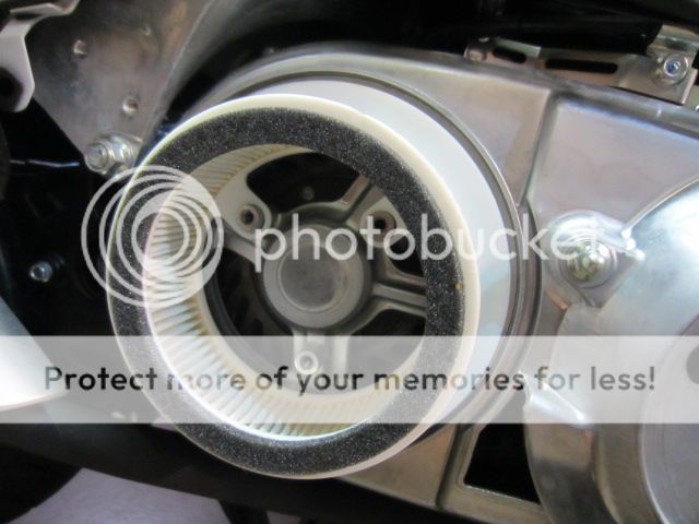

    Next off the the CVT air intake covers and air filter -
    and this -

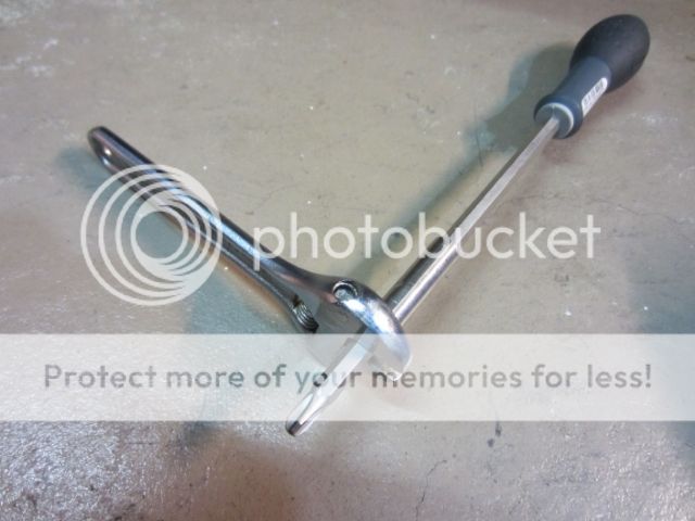

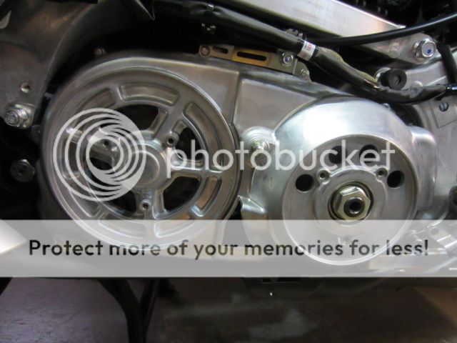

    Used this setup to remove the large crosshead screws holding the covers on here - #3 Philips bit 50mm long, 1/4" driver and an adjustable spanner for leverage - basically insert the screwdriver and push on the handle to prevent the bit rolling out of the screw and rotate the spanner to undo the screw - these are torqued to 7Nm to much too use screwdriver alone. Tip - ensure the #3 bit fits the screws properly before starting this work.

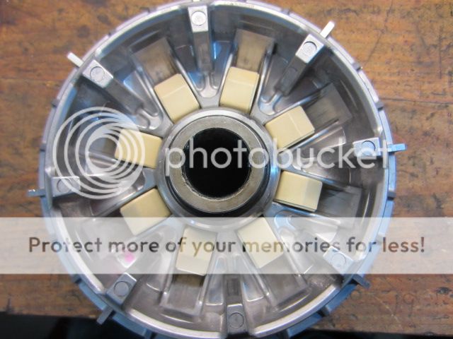

    Now to remove the cover - the large nut on the variator stays for now - remove 6 x M8, 4 x M6 screws and 1 x M6 nut to reveal this -

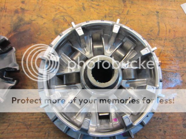

    Now to remove the large nut - use a 29mm or 1 1/8" impact socket and cordless impact wrench - mark the position of the nut on the shaft

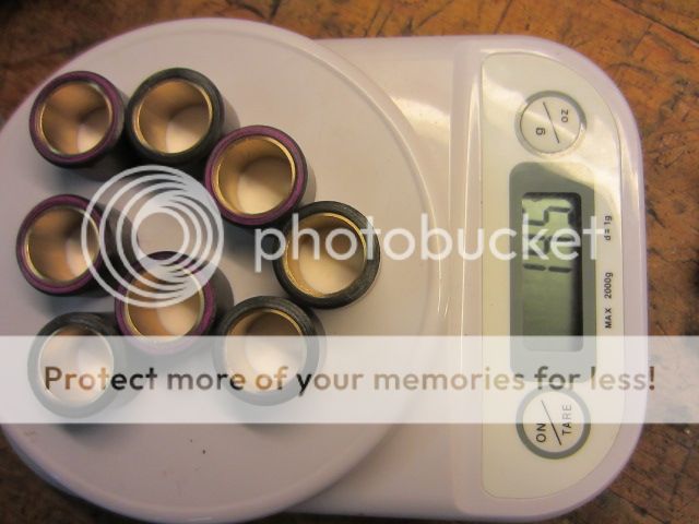

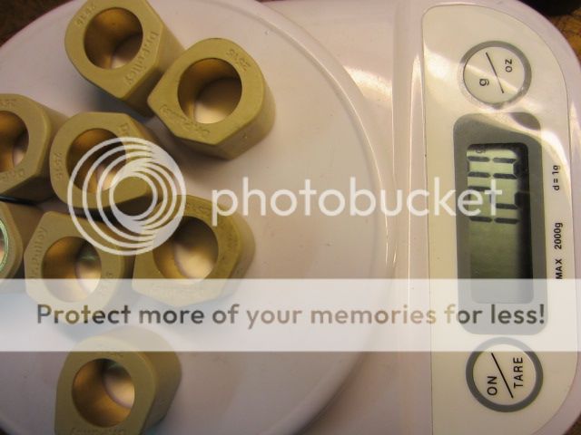

    Here is the variator on the bench with the OEM rollers - 18gm
    Weighted the rollers
    Then the sliders -

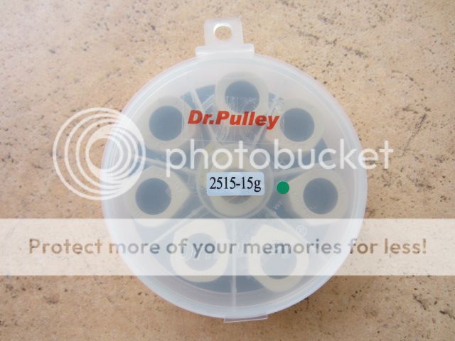

    Was thinking of using 16gm sliders but guys on Tmax-mania forum of France mostly use 15gm - so went for it...

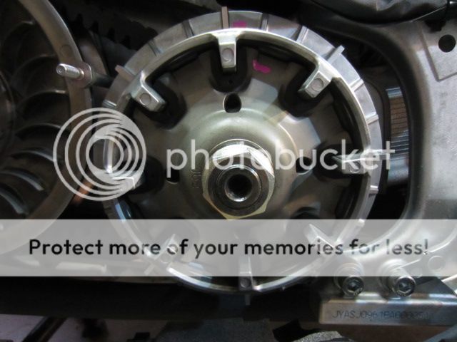

    Finally sliders installed -
    Well the rest of the story is just re-assmbly in the reverse order - lots of screws and clips - probably 2 hours work all up.
    With the CVT cover back on I started up the engine to check the CVT action - the belt is just visible through an air outlet - went up and down as the engine was revved.
