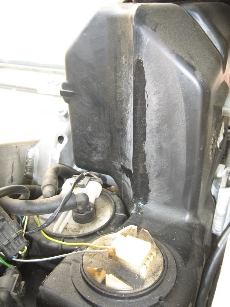

    The dreaded leaking fuel tank

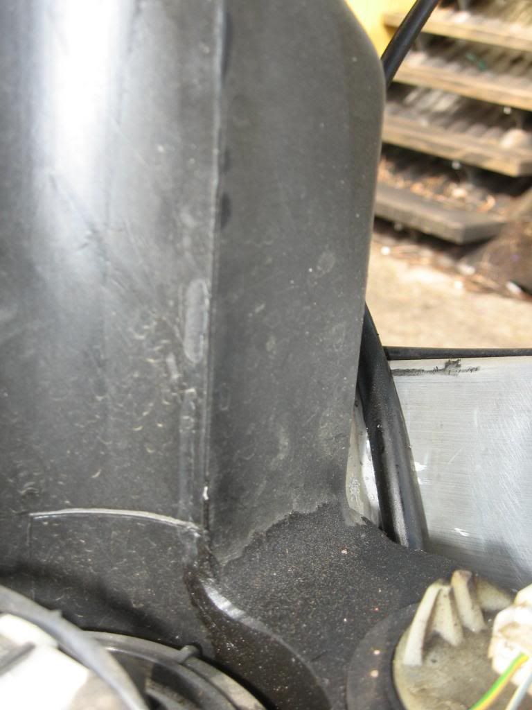

    A warning to all: the fuel tank may start to leak years into service.  In my case it started at the end of 2012, over three years after the 2009 build.  Initially I thought that I splashed some petrol when refueling, but the smell was just hanging around longer and longer afterwards.  It never got to the stage of dripping under the bike, but the garage stank.
     So, I pulled the bike apart again and tried to figure out the source.  The forward edge of the upright part of the tank has a sharp edge and it looked like it may have a separating seam. The wet spot underneath it seems to creep up to the rough weld: surely this is the problem spot.
    So, I got some special Loctite epoxy for plastic.  Cleaned up the area, slightly sanded it, ladled the epoxy on and reinforced with a glass-fibre mat too.  Bike back together, after next fill-up it stank like before.  Bugger.
    Bike apart once again, and the new suspect is the mounting of the fuel-gauge sender.
    I could not tighten it, so I needed to create a seal between the white and grey bits that (a) holds petrol but (b) can be broken easily if the sender needs repairs.  On advice from Loctite I got the  No.3 Aviation Gasket Sealant.  Smeared it on generously and waited for it to dry.  It did not, remained the colour and consistency of thick honey.  Bike was needed, so I put it back together and put it just a few litres of petrol so that it would not reach the level of the repair.  After a week the goo still stuck to my finger.  A couple of weeks later I checked it again and it did not wet my fingers.
    (No photo of the repair, just imagine gunk around the edge of the white mount with the wires.)
    And this fixed the issue, finally!

    Re: The dreaded leaking fuel tank
    silverflyer:
    there was a issue with fuel tanks leaking. i think there was an importer issued fix/ replacement.
    This is well documented in the archives.
    The point is, though, that there is no more importer and the likelihood of free replacement is fast diminishing.
    Neither is there a guarantee about the life of the fix: I have no idea if mine was fixed (bought it third-hand), but did not leak for 3.5 years.  So, beware and be prepared, but it is fixable.
