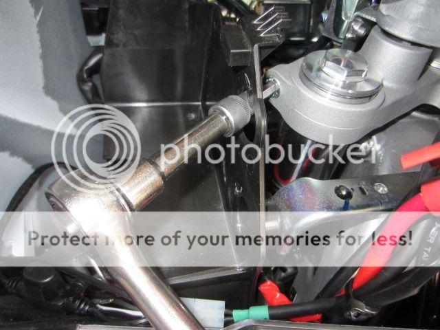

    Use a 10mm nutdriver or spanner - tip ensure the red cover is in place covering the positive terminal when using a spanner - remove the negative wire first. Unclip the rubber strap to remove the battery if required. Remember to set the clock after re-fitting the battery.
    Of course my aim was to get to this screw (just above the red terminal cap) - access is gained with the battery out - the upper fork tube clamp on the LH side - but that's another story...

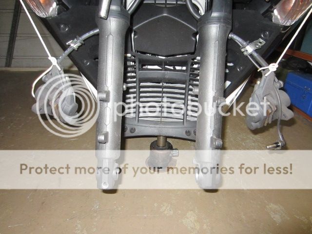

    The work - firstly one needs to detemine how to support the front of the Tmax so the wheel and forks can be removed. I use a brake type hand winch mounted to an overhead beam. Other methods include block and tackle or chain winch. My method uses a nylon sling about the handlebars (will have to remove the handlebar covers) be careful not to damage hoses or wiring. As a safety measure I also placed a mechanical screw jack under the scooter - I used the radiator support.
    Before lifting the scooter remove the front mudguard. Can be done on the Tmax with the wheel in place. Then release the tension on the brake calipers mounting screws, ABS sensor, axle pinch bolt, axle, upper and lower triple tree screws and brake hose clamps. Now lift the scooter so the front wheel is just touching the ground. Remove the brake hose clamps then brake calipers and hang them from the mirrors using light rope. Remove the ABS sensor if fitted, then remove the axle being careful of the LH spacer plate.
    To reveal this - ensure the front brake lever is secured and not bumped while lifted

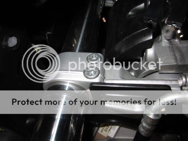

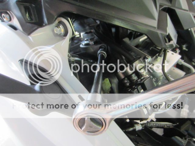

    With a 22mm socket or spanner release the tension on the fork cap. Then undo the LH upper clamp screw - note the battery has to be removed!
    Same on the RH side -

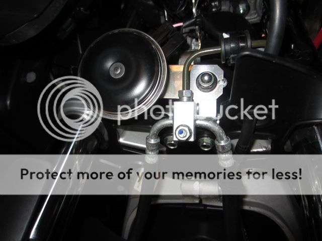

    Remove the horn and mount with a 12mm socket -
