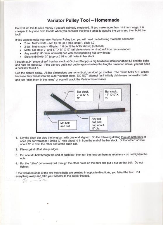

     Hi there.
    You havent specified what scoot you have.
    For my Honda, i use a home made Variator Holder that was designed by a member of a US scooter group i am associated with.
    I am sure you could adapt this idea to suit your needs.
    On the Honda Variator face plate, there is two threaded ports where you simply screw and fix the holding tool onto. Then, simply remover the nut using a qualiity 6 point socket. Whats most important here is when reassembling, you tighten that nut to the manufacturers specified torque. I am lucky enough to have a Honda issued Service manual that has all the Torque values for just about every fixing on my scoot.
    My variator nut is tightened to 93 N-m (9.5 kgf-m, 69 lbf-ft)
    Good luck with it,,,,,,,,,,,
    Shayne

    Thanks Shayne,
    I have a SYM symphony 150 and also have the both the manual and an a parts list for every singly nut and bolt on the scooter which has all the info I need. I have seen many tools like that on various forums. I am thinking of making something up like that myself.  I am pretty handy so I am not worried about the work however it is the lack of tools that is killing me. So its looking like, in order for me to replace my sliders I will need either;
    1. Impact wrench
    2. Alternative tool as above
    3. Torque wrench.
    Those will cost me more than the actual sliders will !!!! Initially thought I would be set with a good socket set but boy was I wrong.
