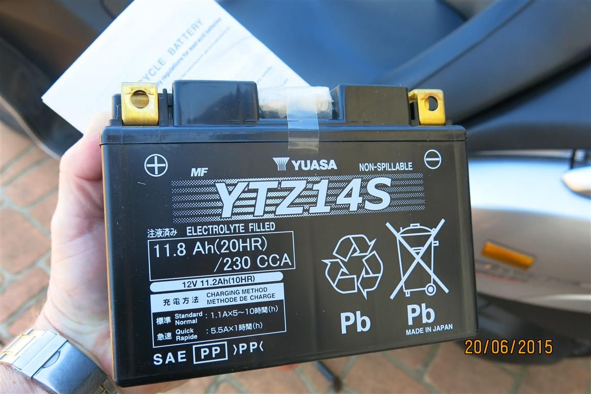

    I looked at Ebay, and there the market is flooded with cheaper knock offs, and was tempted plenty of times by the reduced price over the Yuasa but then the quality over price won in the end............ and $219 later, come home with a new YTZ14S that...... and i am stoked over this,,,, is the Japanese model
    The battery dealer had the YTZ12S (that originally came with the bike) but said that for the same price, they sell the larger capacity YTZ14S, that has the same cubic dimensions as the smaller which will actually perform better.
    Another good service was that they quizzed me on my use of the bike, i.e, how often I ride as well as for how long. Now with my new job that includes a company vehicle, not as often as I would like was the answer.
    They then recommended I consider a 400Ma trickle charger that, will actually be beneficial to the batteries long term health and will help it achieve a longer life span.
    My original Yuasa gave me around 8 years of service and if the new one can match, or even exceed this with better care, I am all for it…
    Heres a few pics of the install. Whats good about this model, is the quick connect adapter that makes hooking up to the charger a breeze.
    It is a nice sound to once again hear a starter motor turning over the motor nice and fast………………..
